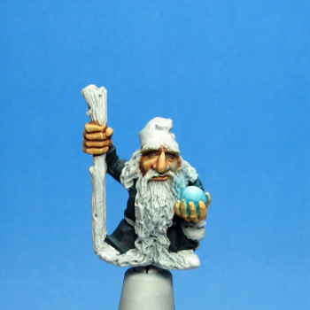

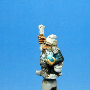

Thanks for the comment. And you're right, I'm not totally satisfied with the light on this model too.
Since I try to build an army with my Marauder dwarves, I wanted to keep the same zenithal light as the one I used for my Ironbreakers, for instance. But this is difficult to make it compatible with a secondary lighting source.
A way to make the magic ball stand out was to paint in comparison dull and dark clothes... which could explain why you're not convinced by their look (I've limited the highlights).
As far as the skin is concerned, it was more difficult, since it's a pale flesh. I tried to paint in darker tones the opposite side to the ball, but I didn't care about the hand which holds the staff... my mistake.

Don't get me wrong, I think the paint job is as good as ever. The main problem was the strong ambient lighting on the staff and then very little on the rest of the model.
It just seemed to cut off and go to a non-lit paint style.
Because of the high standard of your paint work it makes any differences stand out more.

OK. An attempt to translate the article I wrote for our website: http://haekel.free.fr/
First, the clothes:
- base: Dark Sea blue (Vallejo=VA)
- shadows by adding to the base Germ. cam. black brown (VA)
- highlights by adding to the base Pale blue grey (VA)
Now, it's time to see how the secondary light could work. I apply the base colour on the beard, the face and the magic ball.
- for the skin: Elf Flesh + Dwarf Flesh
- for the beard: Pale blue grey
- for the ball: Green blue VA
I apply on the skin a wash of Magenta Ink + Chestnut Ink + Dwarf Flesh. Then I use Shadow Grey and Hull Red to deepen the shadows. For the highlights, I use the base mix, then pure Elf Flesh, then Bleached Bone.
For the ball, I add more and more white to the basic colour, and I underline the shadows with very thinned washes of Turquoise Hawk.
The lower part of the face and the sleeve are slightly highlighted with Space Wolves Grey and a mix of Blue green + white.
For the white beard, I simply cover it with a wash of Codex Grey, then Avaggdu Earth (A rackham Colour, you can use an alternative brown, such as Flat Earth VA). And I rework the beard with Pale Blue Grey, then white, then slight touches (I'm not sure this is English laugh.gif ) of pale blue for the reflects of the magic ball.
For the leather and the staff, here are my colours:
- leather: Germ. cam. black brown (VA), then Hull Red (VA), then Pale blue grey
- wood: Hammerfall Khali (Privateer Press Paint), Thornwood Green (P3 too), Violet Brown (VA) and Menoth White Highlight (P3). Some washes of Catachan Green and Snakebite Leather to finish.
Again, I re-work the effects of the secondary light with blue tones:
No wizard without hat!
I've chosen a dark red to recall the colours I used on my Ironbreakers.
- base: Black red (VA) + Sanguine Base (P3)
- shadows with Black Red + Dark sea blue
- higlights with Sanguine Base + Sanguine highlight (P3) + Khador Red (P3), then Dwarf Flesh. Again, some blue reflects are added to take into account the effects of the magic ball.
That's it!
